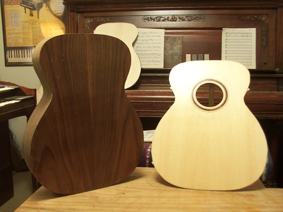

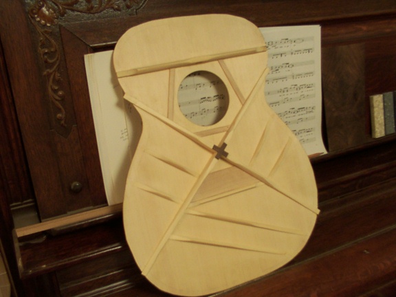

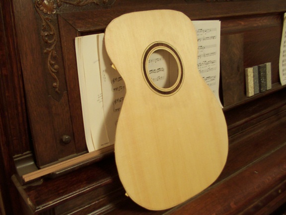

I`m still making progress on this thing! The top is Sitka that I got on Ebay some time back. The rosette is pretty simple with walnut/maple rings.
BTW, I remedied the situation with my oversized head and tailblocks. Surprising what you can do with a 16" McCulloch. Actually, I did have to get a little barbaric, but managed to remove quite a bit of the headblock and half of the tailblock without damaging anything or myself. I`ll post pics when I have a boat to show.

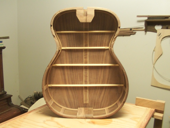

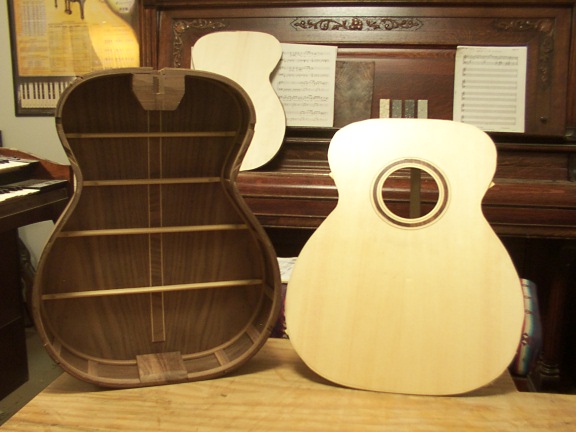

Here`s the latest on my OM. Just about ready to button up for good. Back is on and in good shape. Reshaped headblock as much as I thought i had better and lost half of the Butcher board tailblock I had before.
Any advice on how to get a little more sustain on my soundboard? It`s still plenty thick at .125" and I know that will help some, if not alot. Rings pretty good, though. Just not long enough for what I`m expecting.
